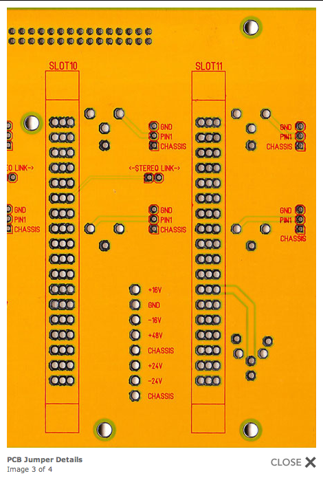

Gents,
I've got a new design 525 that does away with most of the wiring. Only the pots and transformers need to be wired to the pcb.
Provision for a Lundahl 1540, or differential input.
Any interest?
Biggun.. http://lazpro.com/nu525big.jpg

cool Peter. any chance for a stereo link switch?
Sure... as long as the 120R resistor can be put between a pair of pin6s on your backplane.
this is possible 8):
there are jumpers between each slot to connect pin6 together, no problem to install a resistor there:
« Last Edit: September 14, 2009, 03:38:14 PM by [silent:arts] »

« Reply #14 on: September 14, 2009, 04:13:04 PM »
No problem then.
