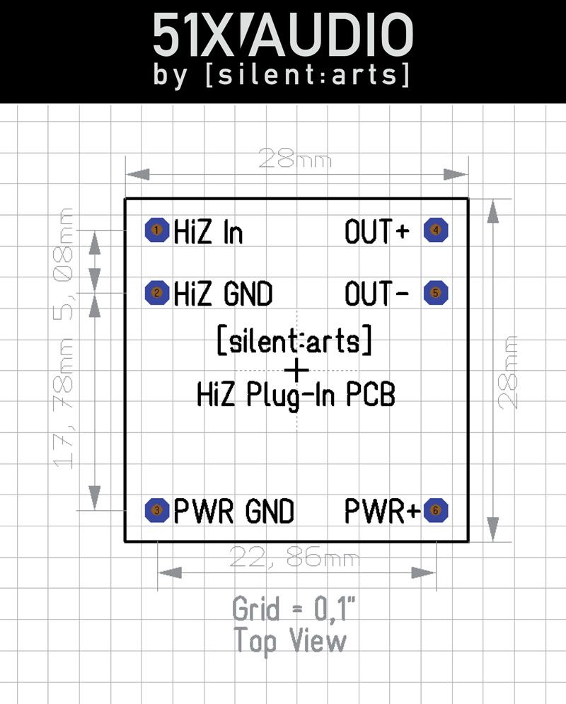

Hi everyone,
Volker aka [silent:arts] and myself have been working on something kind of new the last month or so. It is what we have been calling a “plug-in” HiZ for Direct Inject applications. Our thought is to have a standardized footprint for a small PCB, which can contain many different HiZ circuits for different applications.  The idea is to be modular much like the 2520 DOA concept. Volker has authored the footprint/layout, which is on a board measuring 28mm X 28mm. The board shall contain 6 Mill-Max pins exactly the same type as we all have been using for our DOA projects.
Our thought is that anyone designing, building, etching or whatever…a mic preamp PCB, can incorporate this footprint and use for Direct Inject. This really opens up some great possibilities.  8)

The HiZ Plug-In will run on a single voltage rail. Someone building a standard API style preamp may want to run the HiZ off of the +16V rail. Someone building a Neve may want to run on +24V. A person who has the new GDIY 51x rack may want the option to run on either.  ;)
As you can see, there are loads of options and possibilities.
Here are the basic specifications for the PCB from Volker.

What about including some mounting holes in the standard for securing heavy boards with transformers? Or if that is a tight squeeze, then maybe specify some holes/slots on the main board for threading some zip ties through. Otherwise you will have to make the selection of transformer permanent, and also deal with the inevitable solder joint failures, especially on vertical PCBs.
valid point.
just do it like Sony did it in the old days when they have been using 990s:
leave one socket out, solder that pin directly.
very easy to desolder.
except of the Jensen / Cinemag Plug-In (right now) I doubt all others would fall out,
but the Jensen / Cinemag is already tight (one resistor soldered on the bottom of the PCB).
no place for a screw.
And also, the Mill-Max sockets that we are using are a very tight fit when seated. It takes some force to install and remove a DOA, especially the first time around. I can't say how it will be after many, many plugging and unpluggings. I don't see them working their way loose if the rack is stationary. If toting a lunch box around, I think something should be done to help secure the transformer based Plug-Ins. Zip-ties would be an easy solution that many pro gear manufacturers seem to use freely.
Cheers, Jeff
