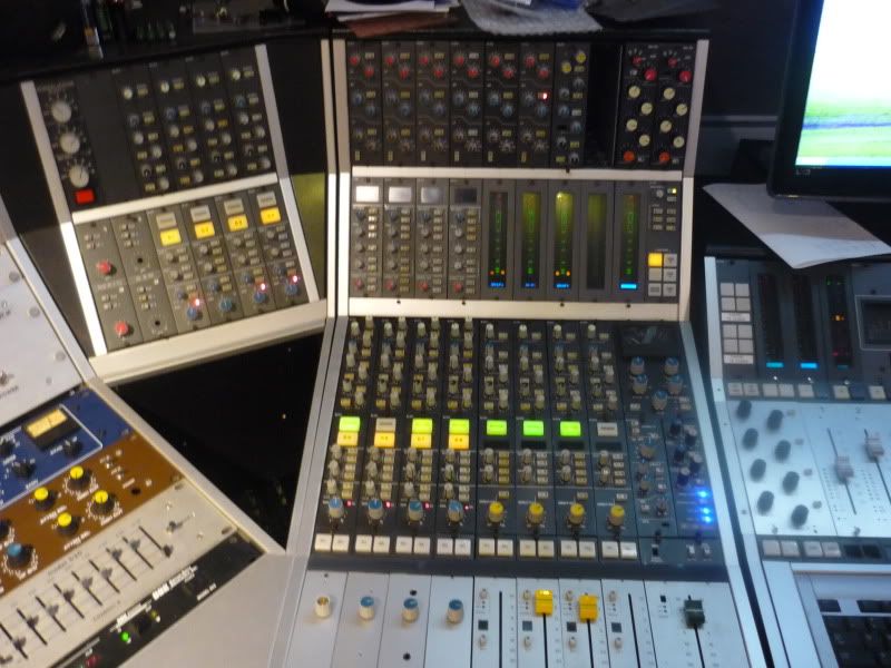

Can't see a picture....
Here's a bit of my stuff, not all though.
Overview :
from left to right :
-19" outboard
-SSL mixing console left part (stereo channels, subgroups, mainbus)
-Daw controller
-SSL console right part (monitorcontrol, dynamics, monochannels, auxmasters and auxreturns)
-FX and patchbay, audiointerface, Midi interface, dat deck.
the outboard, upper rack :
From top to bottom :
-Aphex Exciter (original)
-Behringer analyzer (original)
-Dual LA4
-Neve channelstrip (racked, rewired, diy PSU)
-LA2 (silent arts)
The lower rack :
-dual G1176
-dual Frank enhanced pultec with P2P gyraf SRPP tube amps.
-Urei 530
-BBE 802
The console consists of many modules that I bought from different suppliers (from Swiss, UK, Germany, Uruguay, USA, Canada, Sweden, and Denmark). It took about 5 years to collect them, it also took about 5 years to figure out how to wire the stuff and get it up and running. There are still a few parts that need work, but about 98% is working, and the console can be used for mixdown.
Basically, it has
-4 simple stereo channels (aux, fader, panning, routing)
-4 normal stereo channels (as above + SL522 EQ, filters, insert, inputgain, phase, Direct outputs)
-4 stereo subgroups (aux, fader, insert, EQ)
-masterbuss.
-4 monochannels (SL501 micpre, aux, fader, panning, SL542 EQ, filters, insert, inputgain, phase, Direct outputs)
-4 monochannels (SL 505 dual linepre, aux, fader, panning, EQ, filters, insert, inputgain, phase, Direct outputs)
-6 mono aux, 2 stereo aux, 4 stereo FX returns.
There are also a few custom cassettes :
-2x Nite eq's,
-2x S800 eq's,
-1 stereo and 1 mono Neumann W492  (both need a frontpanel),
-1 dual SSL 9K micpre,
-1 dual Amek BC3 micpre (not yet completed)
-1 M/S inserter cassette with added controls (18dB/octave lowcuts, faderpots),
-GSSL modified masterchannel (added a stereo sidechain with SSC boards to the original SSL audiopath), and
-a not yet completed LA4 compressor cassette.
-modified Listen Mic Compressor.
The routinglogicstuff isn't added, I have found a way to do this differently, to avoid the necessity of buying a G computer. I still have to add battery backup as well. No need for TR, it's just my homerecording set.
The DAW controller part is a seperate section on wheels, and is height adjustable.
basically, the controller is a couple of modified behringer controllers, with some controls for the routing, transport for my revox recorder (which I probably won't use anyway), a logitech keyboard, and a kensington mouse. Also a few LCD meters that show the programme output in VU and PPM, and there's also a seperate dual PPM analog meter.

can I be the first to say thats re F'n Diculous!!!! (in a good way)

That's definitely over the top! Custom desk?

it looks like a go'damn space ship Navigation bridge!!!    GO'DAMN!!!!

Where are the monitor speakers??

Hi Paul,
Holy sh.....!Congrats my friend!
Btw,hows the SL543 going ;D
On the rear. Actually, the console is set backwards, that's why the controller is on wheels. I can move it and locate it in the right position for mixing. I had to make a lot of compromises to get all the stuff fitting inside the room.
btw, I don't have nearfields, only mainmonitors and headphones. (I've recently started doing music again, and I mostly use headphones, otherwise I'll probably wake my 14 month old daughter). I'll add nearfields later on, not sure what to choose though. Keep in mind, this is my homestudio, for personal use.  I'm not planning to do commercial stuff here.
Hahaha !
Dalekian Studio Enterprises.....
Hi Udo ! Thank you. Your SL543 is located next to the FX rack, Aux master 1 and 2. : )
Sitting between his 2 friends, Aux master 3+4, and LMC.
Thanks. Custom, well.... yes, i suppose so. It's actually my collection of SSL modules. I started with 3 modules : 1x 522 eq, 1x 524 subgroup amp, and a 521 stereo line input module. I was planning to make a 4he 19"rack with a few modules, but ended up with this. Insane and idiotic, I recommend to NOT do this yourself. In case I could travel back in time, I'd build something much simpler. Probably something 500 compatible with a custom aux/fader/routing/bussing part. Not this. Waaaaaay too complex, lots of logic stuff in here that you have to figure out.
Thank you.
The GSSL and 9k look great with the handwritten legend ! Maybe I'll do the same with the PRR varimu that I have finished (only waiting for a fp).
